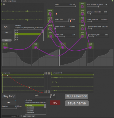

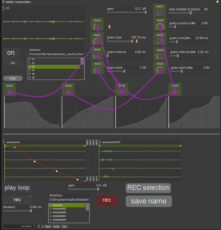

The sampler modules can't save metadata so it is not possible out of th box.
But I did an addon called "player with saved markers" that can save and retrieved markers.
It is not possible to do loops at sample level but.
for this king of thing, I rather use REAPER and make regionss to be render or a specialized sample editor.
Otherwise, I pretty much like the idea of using Usine as a modular studio to produce processed samples (just like with an old school hardware studio)
