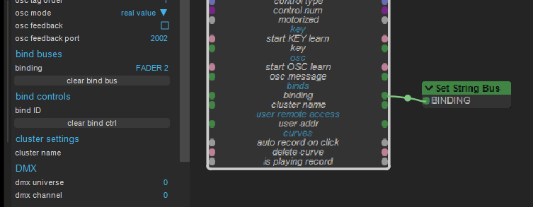

Is there a way to display the "binding" name of an object? I thought the "binding" output was dedicated for this but it's not the case.
I can fly over with the mouse and have a look to the info but I'd like to get it permanently.
Thank you in advance

Precision: the name of binds control...
Unread post by oli_lab » 12 Feb 2025, 16:11
You can get the string value from an output at the far bottom of the full deployed module :
OR
you can use the usine objects with a script
usine.workspace.rack01.patch01.fader-1.binding (TEXT)

Thank you Olivar. But I think we're not talking exactly about the same thing.
I've got a fader A who is binded with another one, fader B (ctrl+shift drag & drop); I'd like that fader A can display the name of the bind control that remoted it.
I don't know if it's clear... I supposed that connecting a panel text (e.g.) to the binding output (same as you use) could work, but it didn't.
Maybe I'm misunderstanding about this output?
Unread post by oli_lab » 12 Feb 2025, 21:07
I got it !
Binding output gives the name of the BUS that is linked to the fader, not a fader
What you can get is the the unique ID number of the fader that is bound to fader A, but only thru the usine-object : usine.workspace.rack01.patch01.fadera.bind-id (TEXT)
then you'll need to search a table made up of all the ID to know the correct caption.
very complicated indeed !
I need to understand what you want to achieve in your workspace as a whole, so I can find a way to do it.

Unread post by Gilsornette » 13 Feb 2025, 09:58
I'm using sensors and I made an interface patch with all the parameteres (as faders or knobs) that is located in the toolbox.
SO I only have to bind (Ctrl+Shift + drag &drop) one of these parameters to the control I want to remote on other patches.
As I have a lot of patches with different kinds of controls, I'd like to display the name of the sensor's paramater that is binded
to them. Is it clear?
Thank you for your help!
Unread post by oli_lab » 13 Feb 2025, 17:58
What I usually do with sensors is to have an interface patch that goes from OSC receive to busses, then you can bind the busses from the bind windows, and get the bind name to the caption of the fader.
If you want to do that from the tool box, I find it a good idea, but not possible as yet. Best would be to lodge a suggestion to OS !
