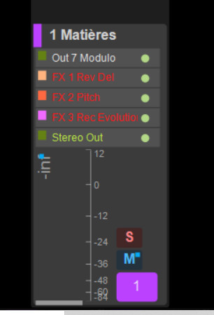

I use a lot of "sends" from one rack to another, and I often apply a controller remote to them.
And sometimes I have suprises when loading a workspace with one of these sends that has been saved at full...
Is there a way to send a reset to these sends on the opening of the wkp?
Thank you in advance.
