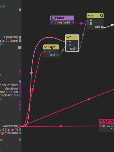

Unread post by oli_lab » 19 Sep 2023, 23:53
Maybe this will help ?!
edit : the "abs" module will do the trick as well ;-)
