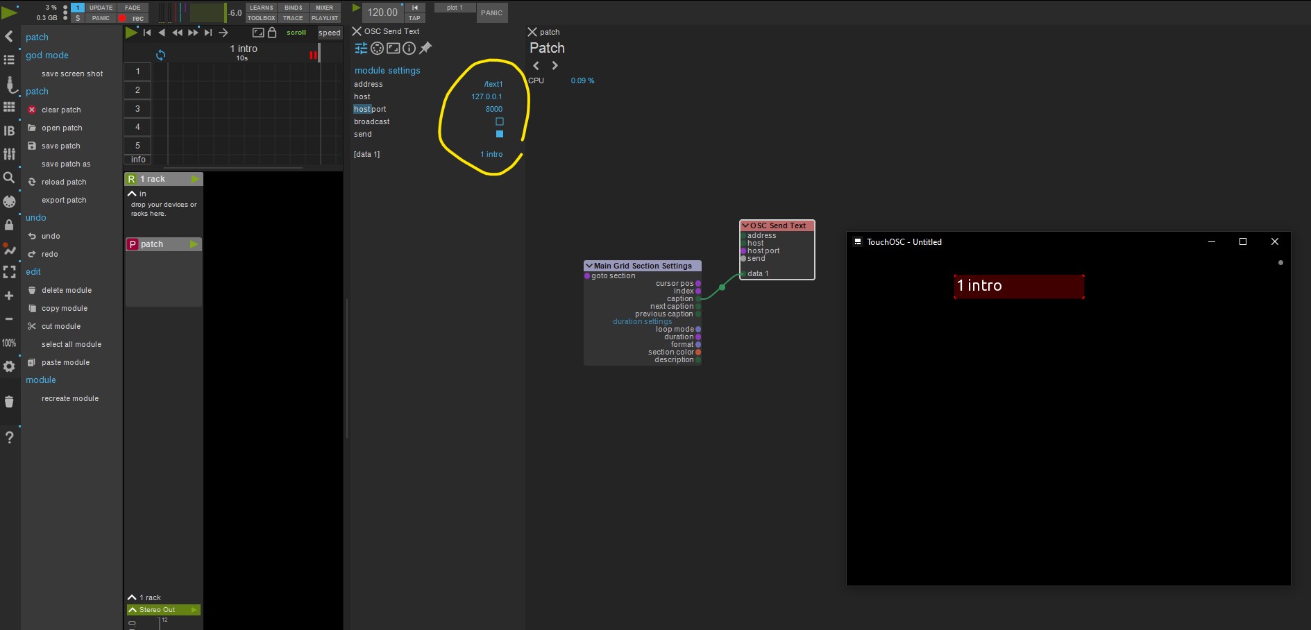

did you try the OSC-send-text module ?
Unread post by rlgsbt » 30 Aug 2022, 18:29
like that.

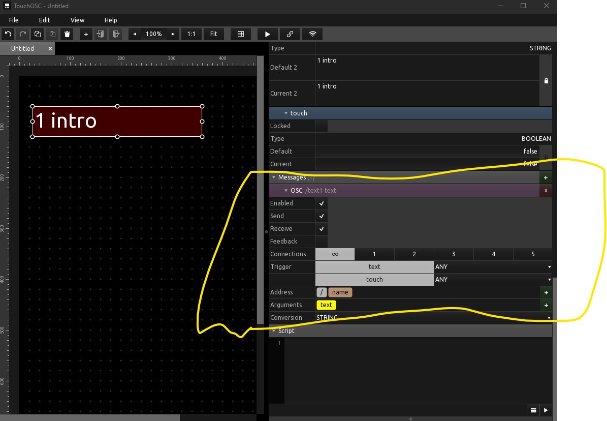

For TouchOSC, the default host port is 8000 in Usine
in touchOSC editor, you have to create an OSC message in the text field :

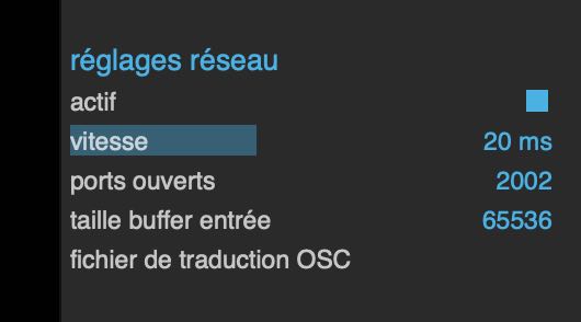

In touch OSC i can configure the Incoming Port and Outcoming Port. But in HH I can only configure one port.
So i configure the same port for in and out in touch OSC. Is it OK ?
Thank you ?
Unread post by rlgsbt » 31 Aug 2022, 18:27
Dans usine, le port ouvert 2002 sert à recevoir les données. Par contre, il faut choisir le port 8000 dans les modules OSC pour envoyer vers touchOsc.
