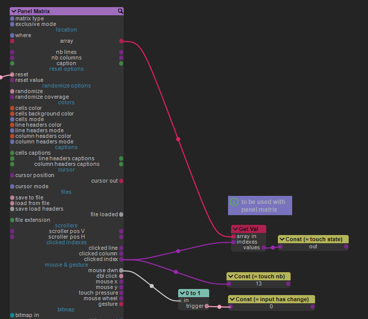

HI !
please note that the part that goes from the array output of the matrix is just here because I plan to use this patch with an OSC interface.
if you're planning to use this patch with a panel matrix and you intend to click directly on it, you can use this mod :

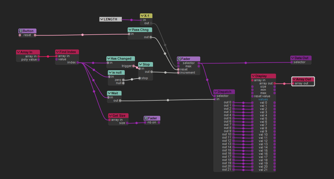

too bad for the challenge, here is a cyclic switch that manages polyphony without midi.
You'll need Modulilab addon because of the addsr module.
I let you test it for bugs

Thank you very much Oli! I'll check in the next few days and tell you how it's going for me.
