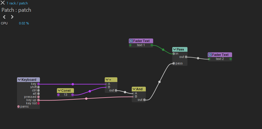

Sometimes PIC module isn't perfect. For regular faders, I can check mousedown. But the mouse is not down when I'm typing into a text fader. The important thing is when I press Enter, and I'd like to use that as a trigger....
Thoughts?
Thanks!!!!
Thoughts?
Thanks!!!!
- Posts: 1327
Okay, this seems to work pretty well...
(for some reason, the 'key' output on the keyboard module is always zero.)
The problem here, which I never know how to solve, is that if I put a PIC module before the text 2 fader, then change the text 2 fader value, and want to update it back to the old text 1 value, the PIC module doesn't see a change, and nothing happens. If I don't add a PIC, then I can't change the value of text2 at all.
I encounter this kind of issue a lot, and I am trying to figure out a way around it.....

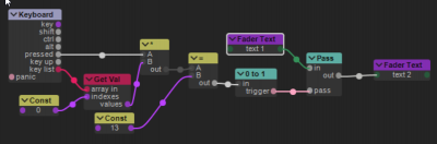

I thought I had the solution. It seemed like the problem was that the key out never changed...
But this still has the problem that I cannot change the value of text 2, even when 'pass' is off. The pass output shows [-1], but the value still won't change.

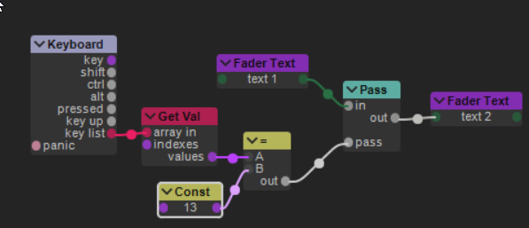

this solution seems to work as expected:
- Posts: 1327
Coming back to this years later.
This patch makes me unreasonably happy. A text fader that triggers on enter, even if the text is unchanged. So great!
Mouse in makes sure enter key doesn't have an effect unless the text is open for editing...
cheers!
cheers!
- Posts: 1327
Well, there is a problem with this. If I escape from the textfield, because I changed my mind, that leaves the mouse value hot, and if I press enter from some other textfield, or for any other reason, it fires, and sends the data.
Trying to figure this out...
Would sure be nice to have an 'is editing' output on the textfield....
