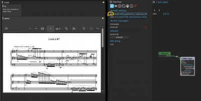

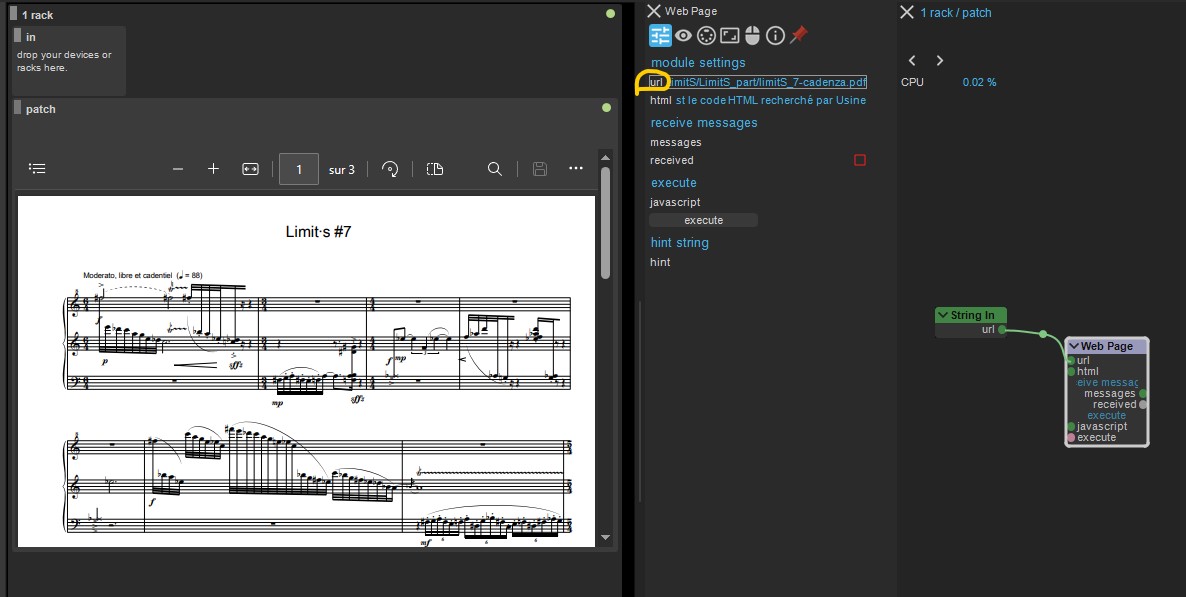

Unread post by rlgsbt » 24 Jun 2024, 08:01
the "Web Browser module" open the default PDF Player (so you can't manage it in Usine). The good solution would be the new "Panel Embedded Web Page" witch also display the pdf directly in Usine. This module display all the needed options BUT you loose the display in IB mode (it's reaching a webpage). You have to click on the URL again.
@Senso, is it possible to force the URL ? a kind of "affect" especially for string ?
thanks

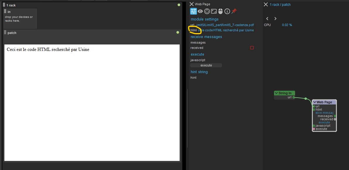

Unread post by rlgsbt » 01 Aug 2024, 08:17
The "Panel Embedded Web Page" module display the pdf BUT you loose it in IB mode (it's reaching a webpage) or each time you change the view. You have to click on the URL again in the "Panel Embedded Web Page" module .
May be you could add a fonction to "affect" the url string in to force the module to display again the pdf file ?
Here is a simple patch which doen't work, but will give you an idea of my problem.
Thanks Senso
expdf.wkp
(106.24 KiB) Downloaded 559 times
