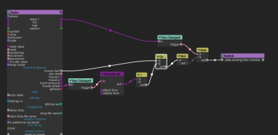

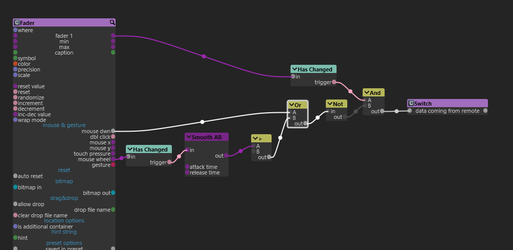

Unread post by oli_lab » 07 Jan 2024, 15:43
an "has changed" module on the fader output would do the trick ? except if you want to dissociate data coming from the remote and data coming from the mouse, in that case :
attack is 0ms and release is 200ms
