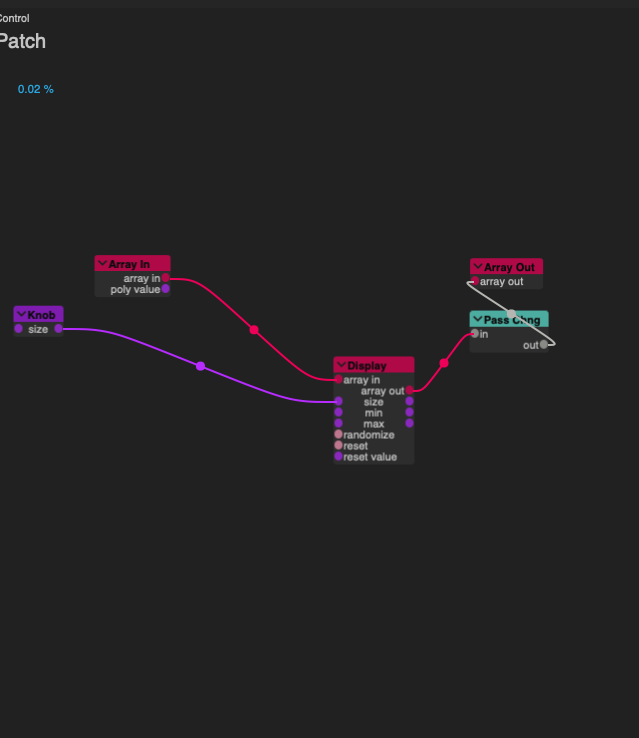

creating GUI works and it is accaptable solution . i was actually testing GUI solution in Usine before i posted this thread but couldn't make it work as didn't figure i had disable "stored in preset"
i have question about how do i use "pass-if-changed" should i put it in between every knob/slider and VST parameter ?
probably yes, see:
Thanks . need to build interfaces then . preset snapshots is the feature i got Usine for . there's potetial i see in Usine so Thx again

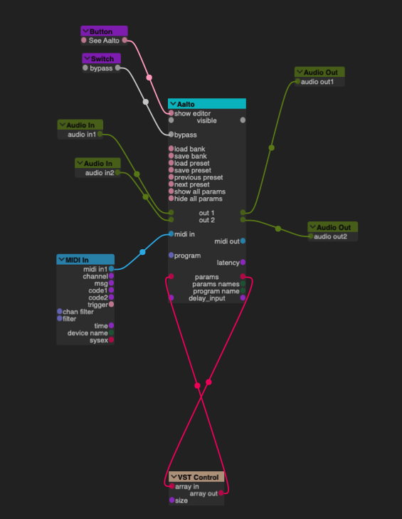

yeap . solution is to untick "Save in Preset" on VST module and it should work fine . also there is a quick solution to avoid assigning parameters to knobs on VSTDAD .you can use array and just control everything from your chosen VST that way if you have lots of parameters on your VST you will save time to map every single parameter to VSTDAD and above else you gonna have to change VSTDAD as it has only 8 knobs doing which is a bit of patching as well . if you untick

actually i've just tested . it works without VSTDAD just fine . jus untick "Save in Preset" on VST module and no VSTDAD is needed . but plugin window jumping around , can't maintain its position . with array it stays in place .
- Posts: 559
Can you explain where / how you connect the Array module to achieve storing of parameters and keep the VST window in place ?
Thanks,
Simon.
Thanks,
Simon.
