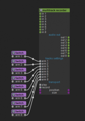

I'm actually on a user module for it, I started to build the transport mecanism with play, record, stop and position request (in % and in seconds).

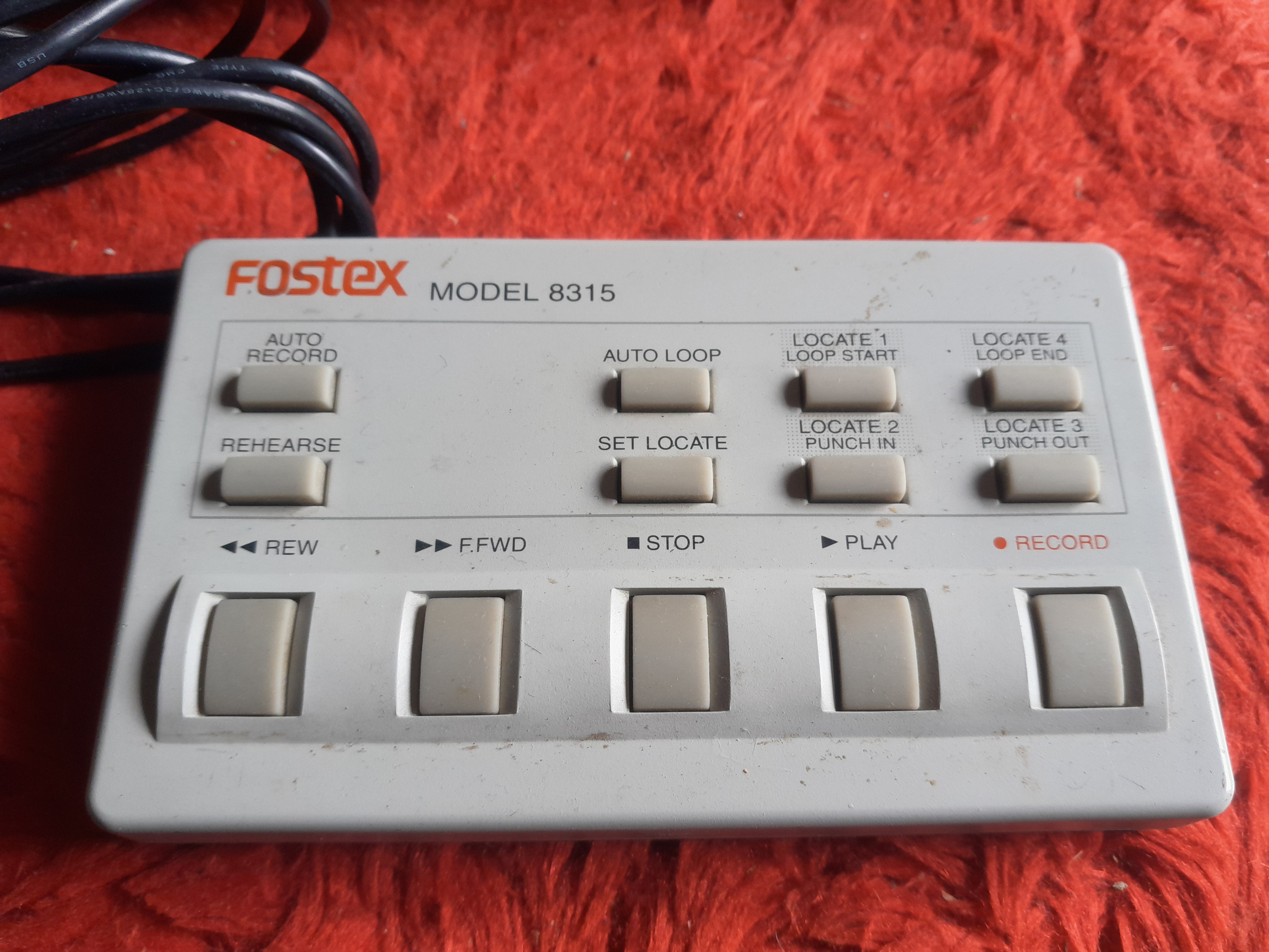

I already have a midified Fostex remote control for it !
I only have trouble understanding how to use the audiofile thingo in the SDK and to link it to my vectors.
Still a work in progress, I choose to stay in the "multitrack tape recorder" kind of thing, hence the "channel/monitor" switches
will probably add few things as :
- a "load file" button (that will induce the need for an output "nb of used track") .
- varispeed at record and play (the chipmunk paradigm !)
- some sort of a wave visualisation, although its clearly a luxury.
- the position input should jog the audio, maybe that can be done by patching outside the module ?
As I said earlier, it is not a DAW, it will be only a simple multitrack "tape" recorder I make for quick and easy tracking inside Usine.
example :
- the rows of switches can be expanded with polyphony number
- the name of the file can be changed with the "string constant" module. again, that can be improved by patching (increment name at each hit on the "save file" button. )
Tell me how it goes !

Thank you for proposing such module!
I've tried it quickly and have noted a few things:
- monitoring switches have a strange behaviour while "listening" to the original sample: if you click just one it soloes the corresponding track, but if you select two or more
no sound is outcoming
- it's a very good idea to have also the ability of recording datas! When looping there's a little audio click (to me anyway)
- for me "some sort of a wave visualisation," wouldn't be a luxury:-) Especially if we can visualize the time shift between the different track. But maybe not easy to do.
- I'd like also to have a graphic difference between arm and record - like the led going from orange to red or something like that. Maybe it's planned?
Anyway, that's really good job, thank you!

thanx for the comments.
next is loading file and varispeed at play AND record !
back to work.
can't reproduce the bug on my side. do you use last HH6 version ?Gilsornette wrote: ↑22 May 2025, 15:51
- monitoring switches have a strange behaviour while "listening" to the original sample: if you click just one it soloes the corresponding track, but if you select two or more no sound is outcoming
the looping is very crude, only there to rehearse before recording , once the recording is done, I guess you'd better load the file in a Usine audio sampler (or reaper) anyway, that's the idea.
Same here, you can load the file in an audio sampler to visualize the recordings, I didn't planned to do a visualisation so far as I use my eyes as little as possible when making musicGilsornette wrote: ↑22 May 2025, 15:51- for me "some sort of a wave visualisation," wouldn't be a luxury:-) Especially if we can visualize the time shift between the different track. But maybe not easy to do.
This can be patched easily outside the recorder module. I'm trying to make the modules as much "patchable" as possible so they can be used in many different ways.It is why the module has as few bells and whistles, only the things that factory modules can't do.Gilsornette wrote: ↑22 May 2025, 15:51- I'd like also to have a graphic difference between arm and record - like the led going from orange to red or something like that. Maybe it's planned?
back to work.
Thank you for your answers.
Maybe it's because the monitoring function has only to be used to monitor the recording and not the audio input (what I thought it was also dedicated for)?
I'm using HH 250506.can't reproduce the bug on my side. do you use last HH6 version ?
it is like an "inline" recording desk : on the same strip you can even listen to the incoming live audio (channel) or what is recorded (monitor)
https://www.audiomasterclass.com/blog/a ... whats-that
did you try the example or just the module ?
I tried the example. But I was mistaken about how it works. Thanks for the "inline desk" explanation. Now it's ok for me:-)
Now in the addons !
Varispeed will be for another time as is very tricky to make a nice sounding speed control. Will explore this with the Hydrogen V5 !
