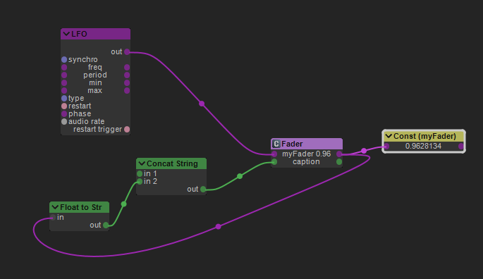

EDIT: Very clever to use the caption value as a monitor. A trick I will use many times, I'm sure! Thanks!!!

I like to use the constant when patching so I can figure out the values, then I remove them when the patch is OK

I like constant for checking values also. THANKS!
