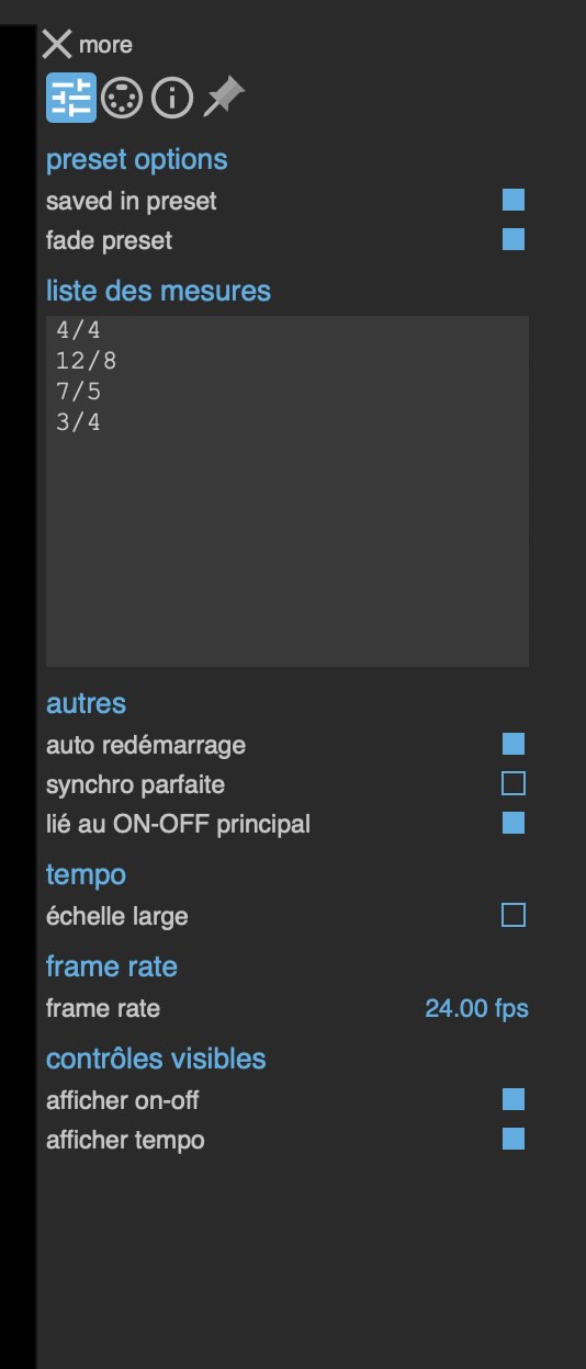

Unread post by cmodica » 24 Nov 2025, 10:57
Right clik on the tempo open a window with some tempo setup.
Here you can write the bar list you want for your project.
This list is save with the project.
