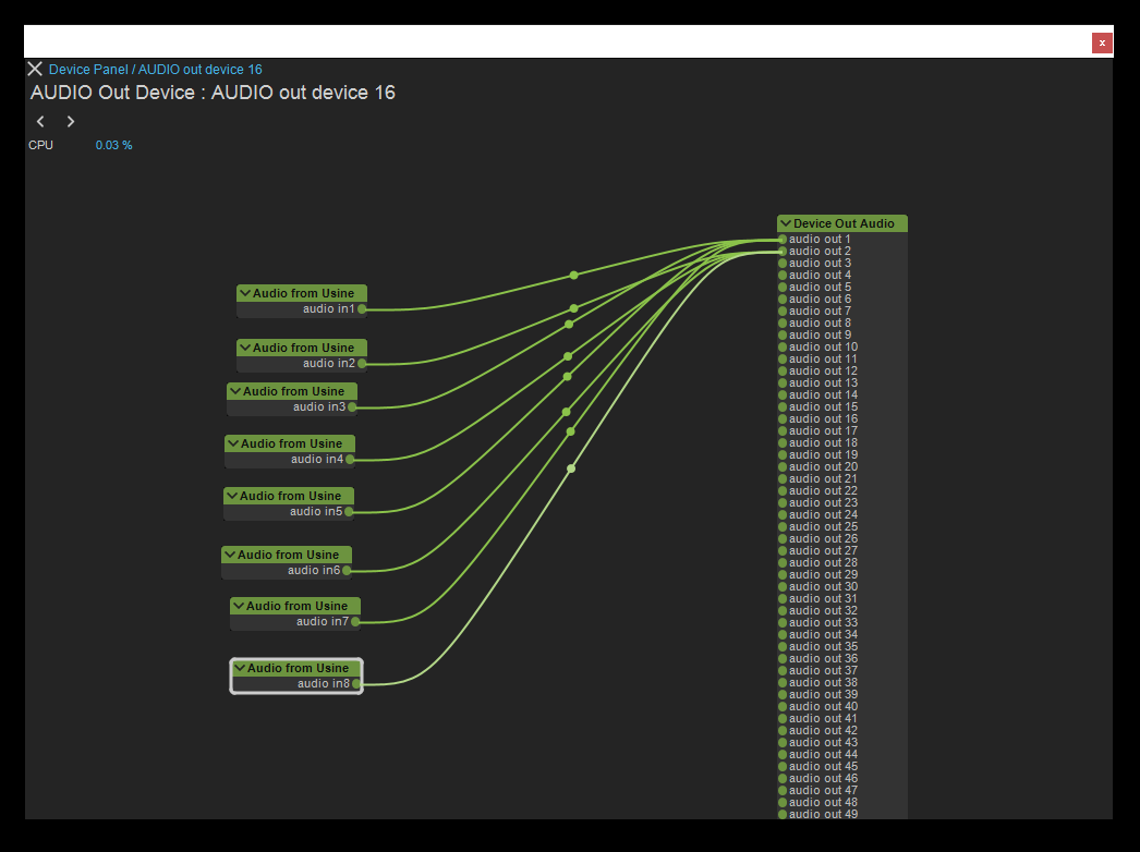

You could try creating eight audio devices (OUT1 - OUT2 - OUT3 - OUT4, etc.) connected as follows:
OUT 1-> Audio 1
OUT2 -> Audio 2
OUT3 -> Audio 1
OUT4 -> Audio 2
etc.
Add meter views to each audio output in your patches to see which tracks are playing.
For the 8 track recording, I'm not sure that it will work. Probably that when you export OUT 1, you'll be recording 1-3-5-7, and the same for OUT2...
Perhaps you can record them individually by putting them on SOLO?
There are certainly simpler solutions. An 8-input, 2-output matrix? A way to create a virtual 8-output sound card?
It's worth trying.

As long as the output of the rack is 8ch it will record 8 channels
even if it's patched like that inside (so you hear everything in L & R Channel

What I suggest is to do all your patching with 8 channels then, at the end of the audio chain, you insert a patch with 8inputs and 2 outputs and use the GRM space VR so you'll have a binaural monitoring from your headphones.
when done, you can use a 8 channel output device instead of the stereo one, deactivate the patch with space VR and record your octophonic piece with the Usine recorder by dropping the octophonic device inside the recorder
