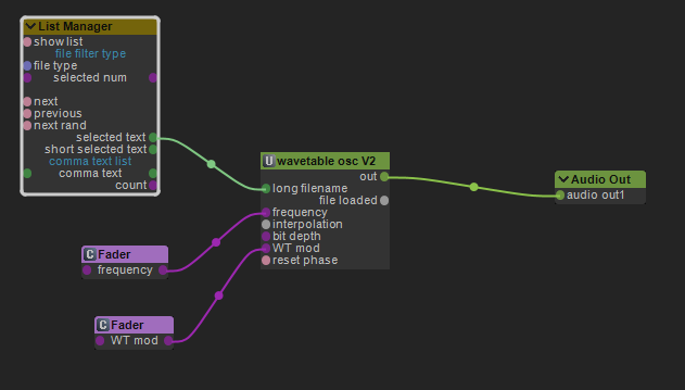

I've loaded wavetables as wave files but when I change the frequency I've got strange results: non linear response, inconsistent, and not following the frequency curve.
As the recording attached. What am I missing?

try the module from Oli_lab, it is more compliant with different wavetables ans has a interpolation option for smooth transitions between waves !
It works fine with this module. Thank you!
I checked the code for the module and there is an alogo to cater to different format of waves :
if its a PPG wave, it's less than 32768 samples and divided in 64 one-cycle waveforms, otherwise, if it's bigger its divided in 256 one-cycle waveforms.
I'm working on a new version of the wavetable module with more tweaks !

I fixed a bug in the wavetable reader V2 module and made a V3 pretty much improved !
need to update the modulilab and oliloscope addons.
check the example here : enjoy !
