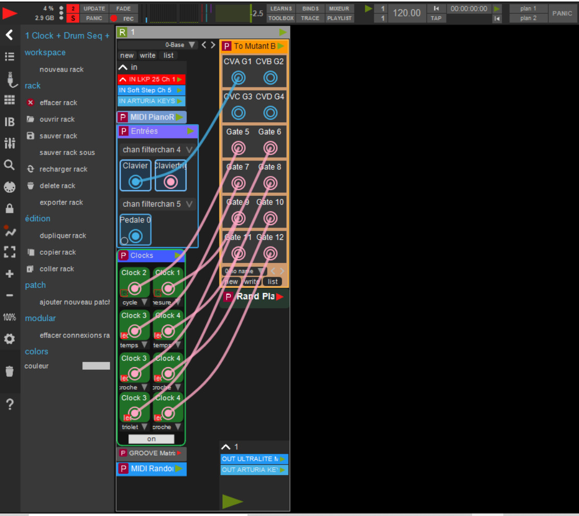

But is it possible to send a clock from Usine to Modular Synth via BeatStep?
Can I program a sequencer, or a complex LFO in Usine and transform them into GATE and CV via BeatStep to send them to the Modular Synth?
I would like to use the power of Usine to modulate my Modular Synth ...
There are modules that transform midi into CV. But there are few of them and they are expensive. If someone has already experimented with this, I'm interested.

I’m using this one http://www.hexinverter.net/mutant-brain which is really "multipurpose" ( several cv, gates, you can configurate as you want...), but have no USB and is not cheap.
Or Doepfer Mcv 4, cheaper but with less possibilities https://doepfer.de/mcv4.htm
The mutant brain serms to be very usefull and not so much expensive. The Shuttle Control by endorphin.es is very more expensive.

Is it easy to patch in HH for work with it ?
https://www.endorphin.es/modules/p/shuttle-control
… but there is an usb plug.
Yes, it's quite easy to patch. I use a rack with midi inputs and clock sources that I can patch to Mutant Brain.
Here is a screenshot
