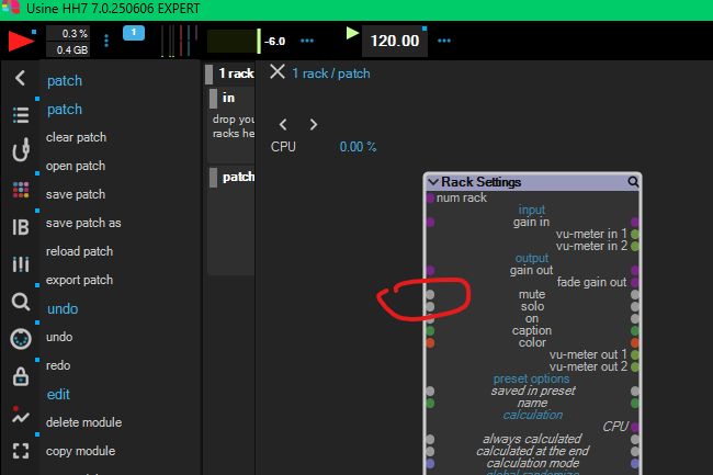

The answer is : rack settings module
Thanks for your reply... I get the idea but it doesn't work for me. All the audio sources are in the same patch

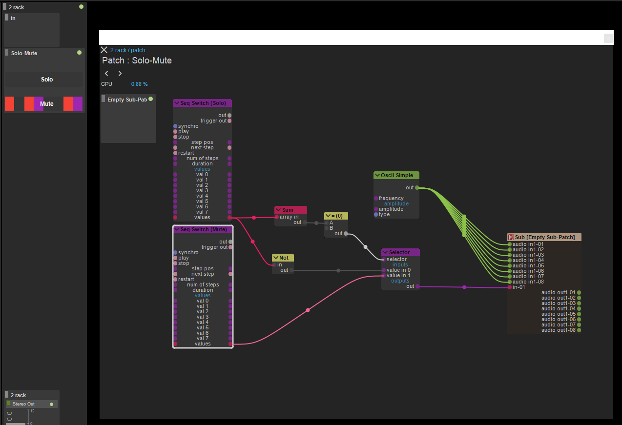

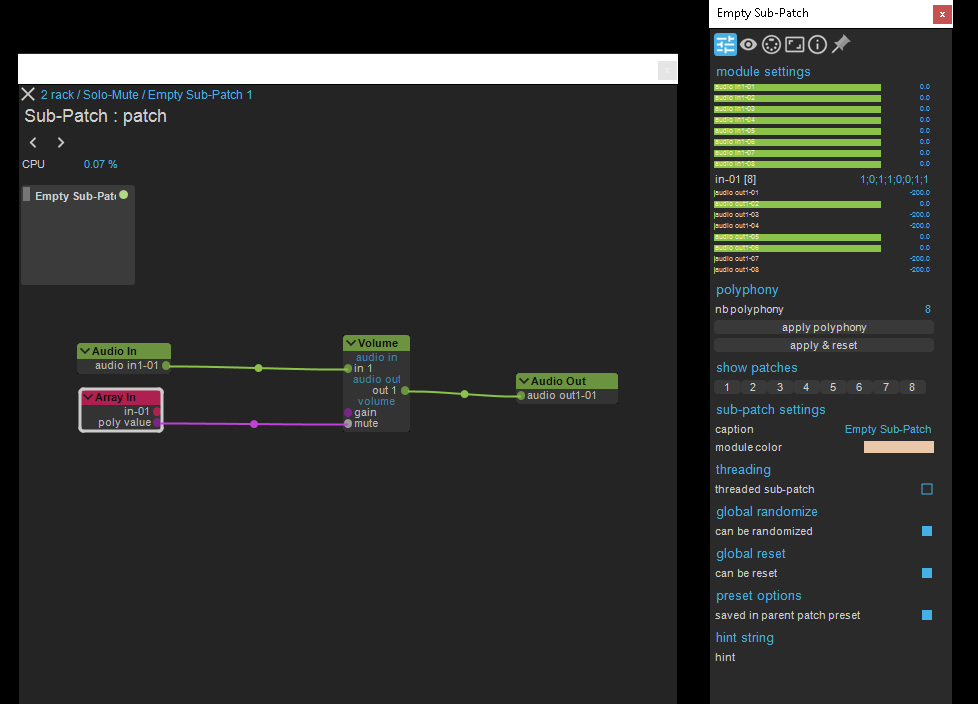

if all your sources are in the same patch then you can make a sub patch with a mix volume in it (and as many voices as you need) and use seq switches to get array of values for muting each voice of your poly sub patch for the solo there's a trick :
If array from solo sum = 0
Array from Mute act on mute in the volume (muting each corresponding voice of the sub patch)
but if array from solo sum > 0
then the Array from solo is used (with logical not every not selected voice would be muted)
Hope it helps

- Solo-Mute.pat
- (31.47 KiB) Downloaded 234 times

Well done Greggo, very cleverly designed !
Here's my 2cents : Yours is ligther on the CPU but.
Yours is nice too Oli (and it calls grouped switches concept)
and the VU meters are pleasant
