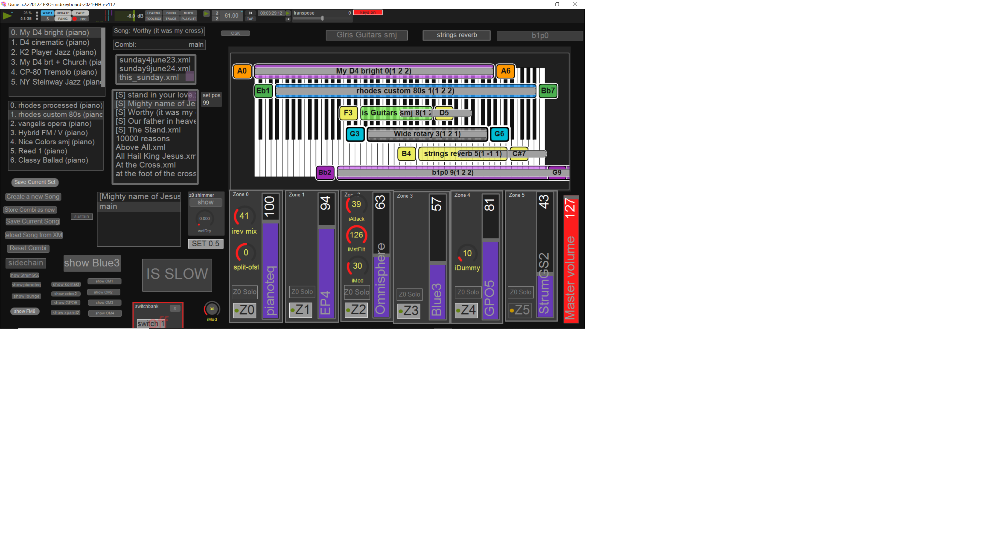

3. The other is a massive midi zone type module I use for live playing, a bit like Mainstage. I'll post a screenshot.

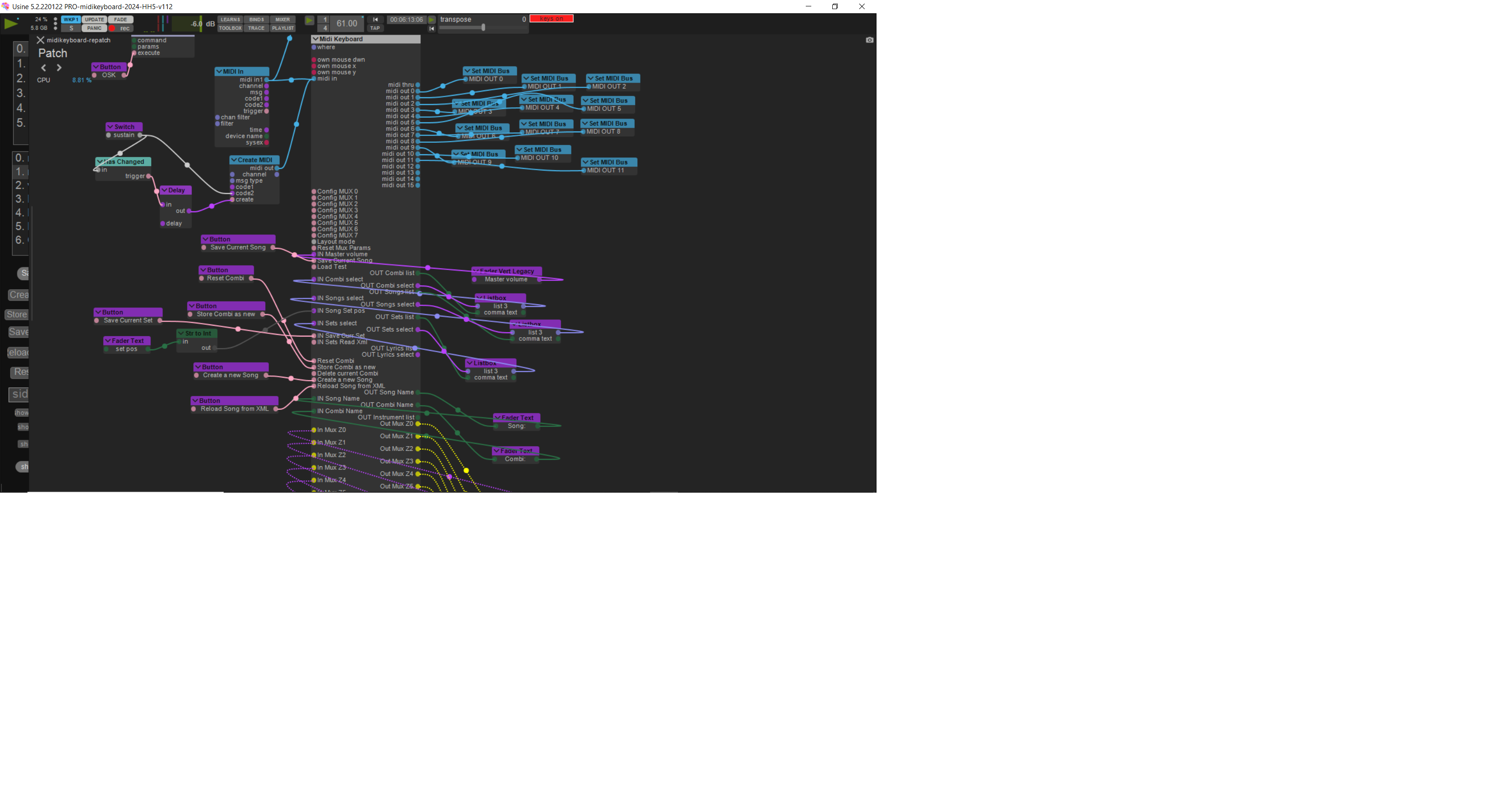

Here are screenshots of my big module:
In the wiring, the Mux outputs go to channel strips via my ParamMux module - the midikeyboard module writes directly onto the wire many types of events (2 levels of mux) that are extracted by ParamMux modules at the other end to operate the faders etc.
I was thinking of using Usine Objects for some of the control, but its slow and there is no fast feedback path for changing values - so its good for sending but not for receiving changes to events.
