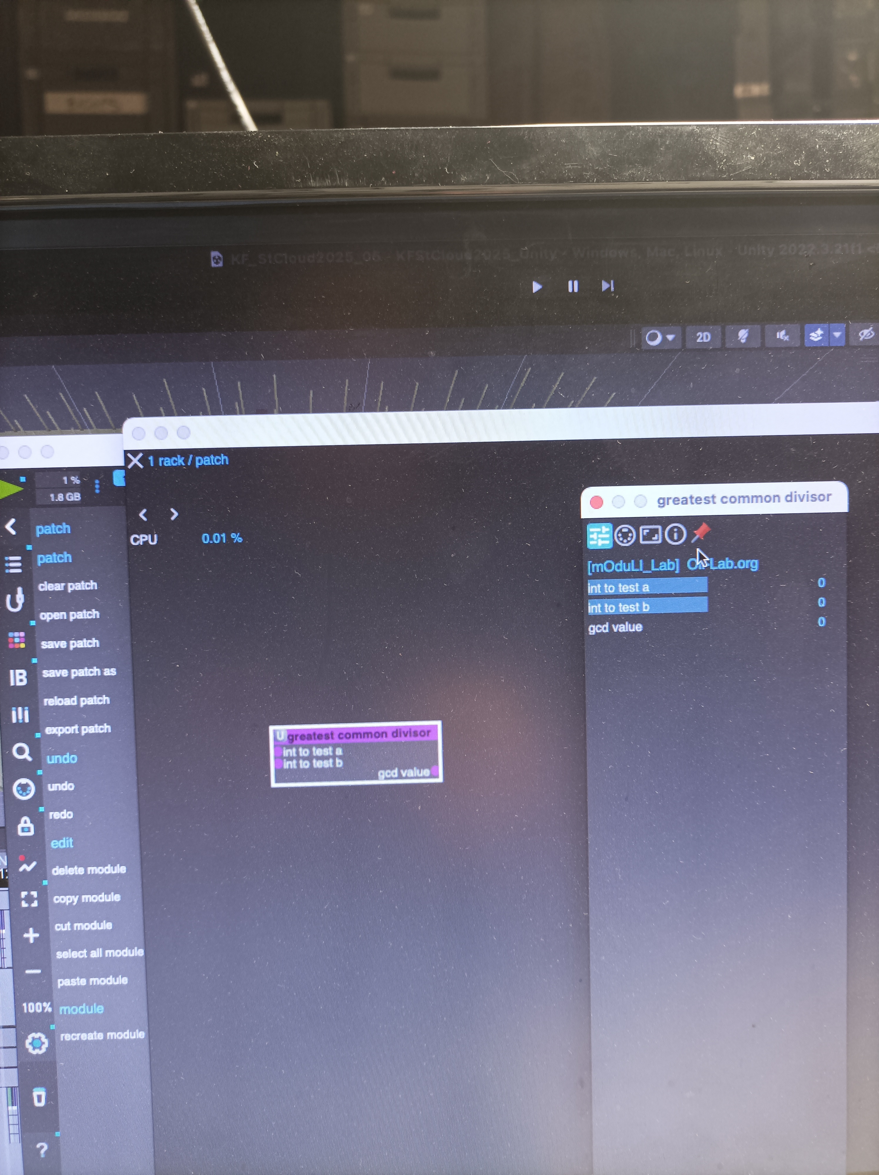

Unread post by oli_lab » 08 Nov 2025, 10:46
if someone can load the GCD module (datalab/math) into a M4 and tellsme if it is loading alrigth, that would be great !
thanx

Unread post by grego mondo » 09 Nov 2025, 00:52
Load all right

can you try to load the GCD module (datalab/math) into a M4 and tell me if it is loading ok ?
load ok ! 8)

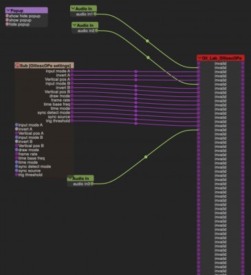

All the Data_Lab are loading well. Except "ADDSR V3". The "ADDSR V2" is OK, but the V3 is invalid.
All the Moduli_Lab are loading well. But
- "Velvet Noise" and "Wave Extractor-V2" send a "(2) Error : in Process" in the Trace panel.
- Wave Recorder V2 is Invalid
- Wave Recorder V3 is OK
- OliloscPe-3ch is Invalid

Unread post by oli_lab » 26 Nov 2025, 20:13
HI !
these have been updated for Macos and should be OK now, thanx for checking if they alright on you side.
It is uploaded in the addons :
Olilloscope 3ch (Olilloscope)
in the modulilab :
ADDSR V3
wavetable reader V2
wave packet V3
Velvet Noise (added the sparsity input for fun)
Wave Extractor-V2
Unread post by cmodica » 27 Nov 2025, 17:37
hi.
They're all okay.
But the Patch exemple "OlilloscOPe.pat" is not OK.
