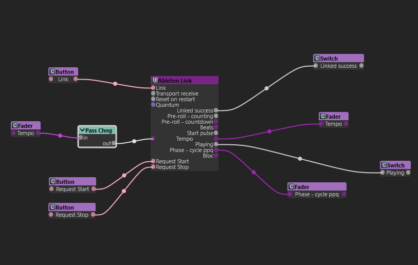

So, as tittle suggests, tried to build some custom Usine tailored user module for Ableton Link Protocol.
*should* work with the 244+ daws/apps/HW that are "Link protocol" compliant, (like for ex Live, Bitwig, PT, Cubasis, Logic , Reason, n NI Maschine or MPCs hardware, ect..
(tho i only tested with ableton live atm tbh..can, and will check in BW later on..)

Unread post by oli_lab » 19 Dec 2023, 23:13
I tried between 2 instances of Usine on 2 computers on a LAN : it's working,
I can compile for MAC if you wish
cheers !
Unread post by oli_lab » 19 Dec 2023, 23:29
only it needs a pass if change on the tempo input :
Unread post by oli_lab » 19 Dec 2023, 23:58
Another question : is it possible to choose the number of beats per measure (3/4,5/4,7/4,11/4 etc...) ?
Or are we stranded on the power of two Ableton Live paradigme forever ? ;-)

Unread post by 23fx23 » 20 Dec 2023, 07:18
didn't try tbh,
but i suppose could set quantum to beat as beeing the shared 'granularity'
both daws to whatev same sign, then quantize ply/stop commands to what want too i think on the daws

Unread post by 23fx23 » 20 Dec 2023, 14:20
thinking back of it, problem is it would make phase out only go from 0 to 1..
so.. i could prob either make quantum param to be user set in arbitratry integer beat number
(did a combobox here for 'conveniance' like in my / prob most widely used case easy swich from beat, to bar or 2 bars)
then internally it used a power of 2 from that list choice to translate to 1,2,4,8,16 ect beats quantums.
but indeed that only make sense in the general 4/4 case..
or could keep it that way, but let man enter nb beats per bar yeah, and change internal conversion function, maybe better..
mmm will think about it
Unread post by oli_lab » 22 Dec 2023, 08:54
+1 ! that will make it usable for non 2-powered musicians !

Unread post by 23fx23 » 27 Dec 2023, 10:08
uploaded new version with added "Beats per bar" parameter
tested fine with Bitwig, ableton live
